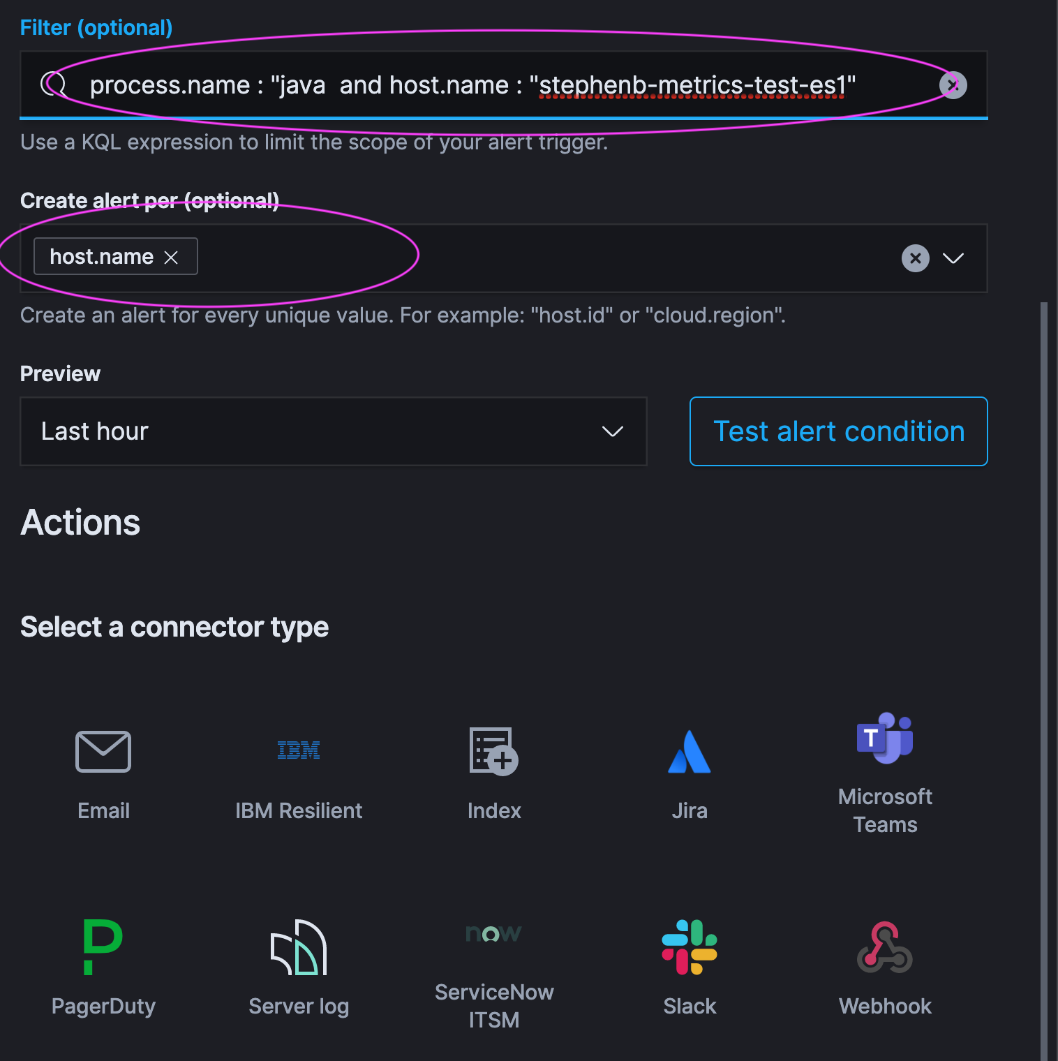

Assuming you mean the new Kibana Alerting Framework.
You can test to see if there are no metrics reported with that process.name
You could also check the process state if you wanted.
Alert Type : Metric Threshold
Thank you but this filter is for processes and not for services. Can I add a filter for services like this?
You can filter on any term in metricbeat ... services are processes are they not?
Can you give an example?
Can you see the testservice.exe reported in metricbeat data?
Take a look at the exported fields
Yes that is correct. I was not monitoring the testservice.exe in my system.yml file. Once I did that change I was able to see it in the metrics.
