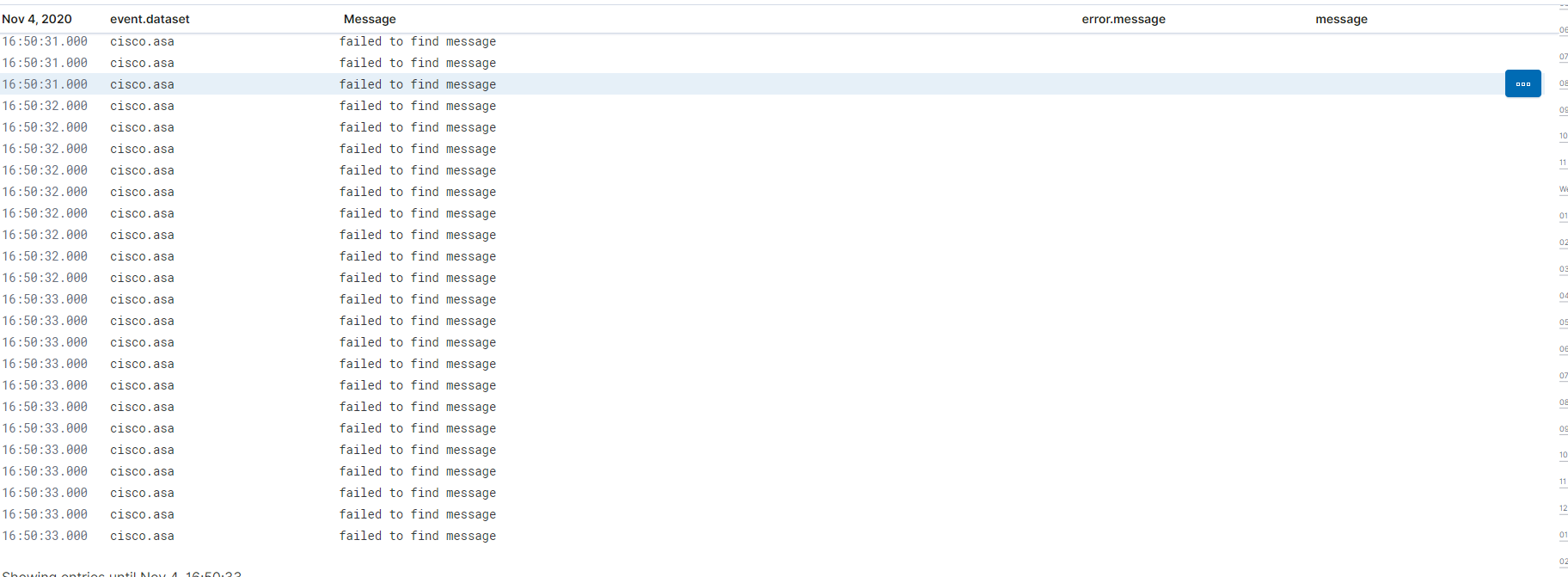

Hello,
I want to drop all events that filebeat was unable to parse.
I tried a few things my last attempt looks like this.
processors:
  - drop_event:
         when:
         and:
         - equals.event.module: cisco
         - equals.message: "failed to find message"
But I can still see the events with the message "failed to find message" in kibana log stream.
How can I make it work?
Filebeat version is 7.9.2

I have just noticed that this probably is not taking form field I thought It was.
Oh wait, so that's an issue. Please, can you also open a GH issue here https://github.com/elastic/beats/issues so that someone fixes it?
By the way, about the yaml indentation, Filebeat won't give an error if your yaml is incorrect (correct YAML syntax but incorrect Filebeat I mean). It will simply think that the setting isn't there.
One last thing because after looking at this again, there's something I don't understand: Where do you get that message?
Your Cisco message is, for example,
Teardown TCP connection 23913857 for name-1:ip-2/49903 to name-2:ip-3/23 duration 25:54:08 bytes 4095435 TCP FINs.
And your error.message like:
Provided Grok expressions do not match field value: [Teardown TCP connection 23913857 for name-1:ip-2/49903 to name-2:ip-3/23 duration 25:54:08 bytes 4095435 TCP FINs]
So, for example, you can drop messages that contains Define processors | Filebeat Reference [8.11] | Elastic an error.message field.
I have change It to
and added field in logs
processors:
  - drop_event:
         when:
         and:
         - equals.event.module: "cisco"
         - has_fields: ['error.message']
I don't get this output at all right now.
Sorry I didn't explain myself properly. I mean where the message is produced. Is this message produced in Filebeat Cisco module?
I am sending directly from filebeat to elastic.
As Kiban stands this "Message field is derived from document fields"
It's working the last document with this field I got from
"@timestamp" : "2020-11-04T16:52:58.000+01:00",
