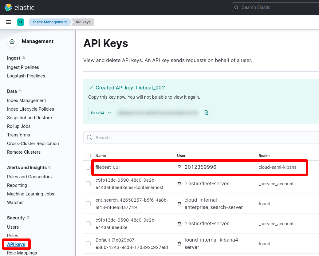

I create api_key from here:
my_login_id : the user name that I used to login the cloud elastic stack
my_pass_word : the password that I used to login the cloud elastic stack
