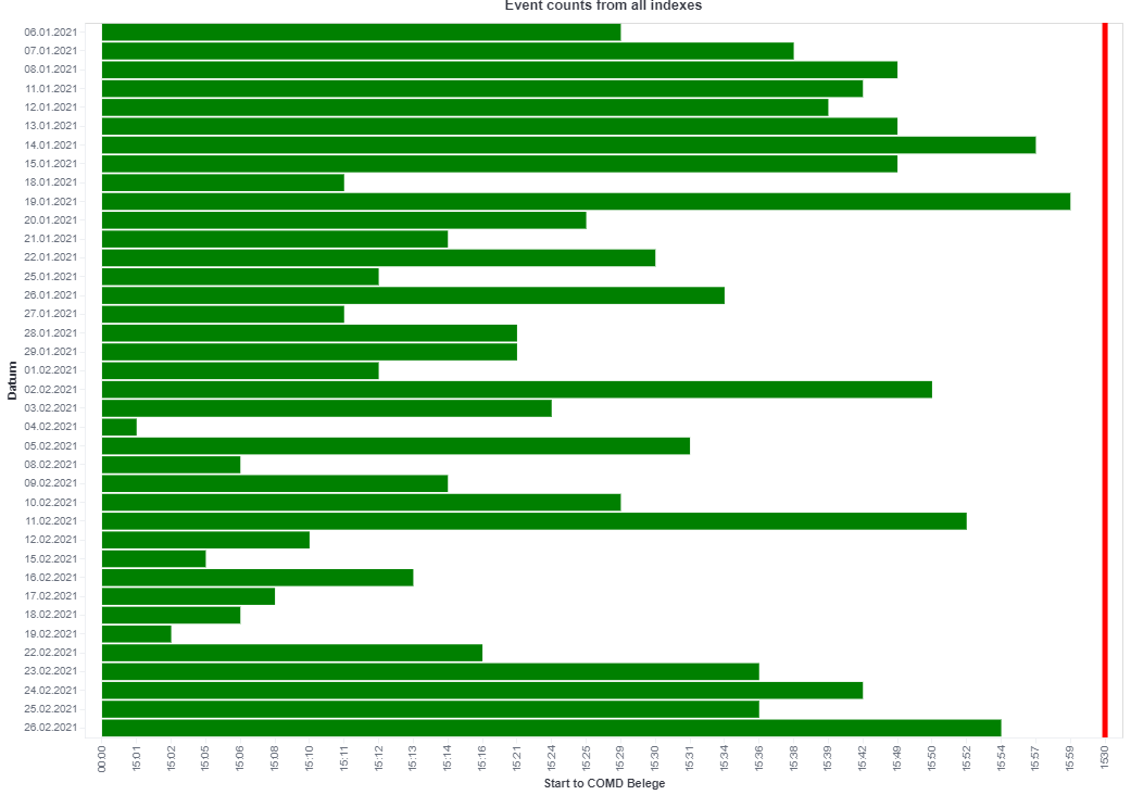

hello all,
I am trying to fix a fixed line to the x acse where time = 15:30 so that I can notice the bars that took longer than 15:30. what have i done wrong?
tha is my Code:

the result is :slightly_frowning_face: :
Can you try setting it to
"value": 1331321
where you replace 1331321 with the equivalent for 15:30 instead of doing all that calculate stuff?
You would have to remove the aggregate, the type and the field properties.
