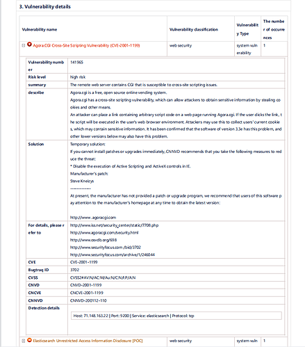

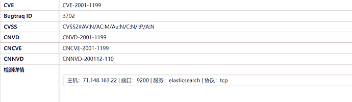

A cross-site scripting vulnerability( CVE-2001-1199) was found in Elasticsearch:9200,I've never seen it before,so how to fix it, anybody helps?
full report like that,Elasticsearch Version: 7.9.0

CVE-2001-1199 is a vulnerability in a system called Agora which is unrelated to Elasticsearch. Are you using Agora? If so, you need help from someone with Agora expertise. If not, your vulnerability scanner is buggy. Either way, I don't think this is the best place to get help.
