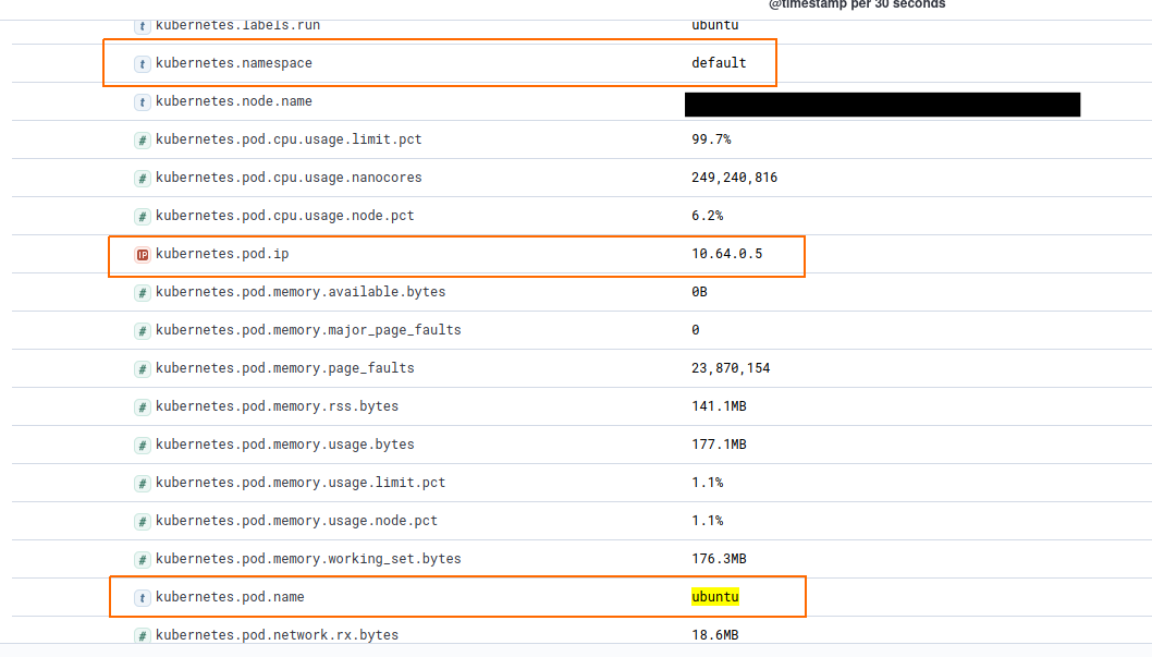

Hi. Does anyone know how to get kubernetes namespace in webhook alert payload from metricbeat k8s module? Or more generically, how to access the event data to include in the payload?
I installed metricbeat on kubernetes using this guide: Run Metricbeat on Kubernetes | Metricbeat Reference [7.15] | Elastic
and I got this data:
However, when I created a webhook alert, with this payload to see the all available properties:

Anyone know how to include the kubernetes.namespace from the source to the alert payload? I need it to be able to identify the pod in the alert uniquely.
