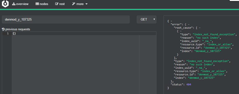

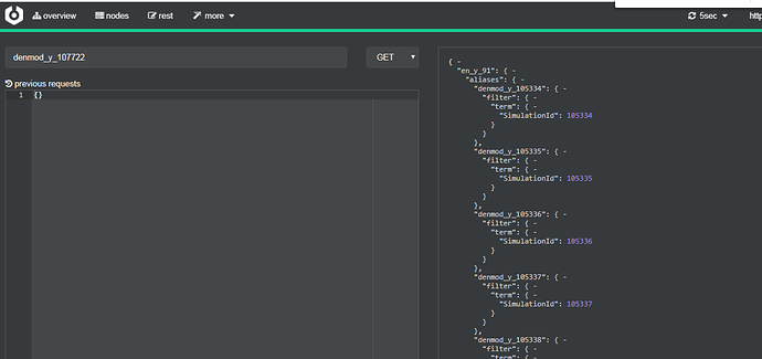

please check the below screenshots,
Screenshot 1 :
Image output shows data available but still cmd output shows found false.
Screenshot 2:
Image output shows data unavailable(i.e. index not found) but still cmd output shows found false.

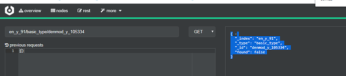

Can you please share the output for
en_y_91/basic_type/denmod_y_105334

Did you mean the below query ? as the above mentioned by you is wrong.
en_y_91/basic_type/denmod_y_107325
Joseph_Raj:
denmod_y_107325
denmod_y_107325 -- it represents ID right .. i wanted to see what data it fetches for this en_y_91/basic_type/denmod_y_105334
Joseph_Raj
(Joseph Raj)
February 13, 2020, 12:02pm
7
It remains the same output. Check below.
It looks to me like ‘denmod_y_107325’ is an alias rather than a document id. If this is the case you need to query using the alias rather than the underlying index name.
