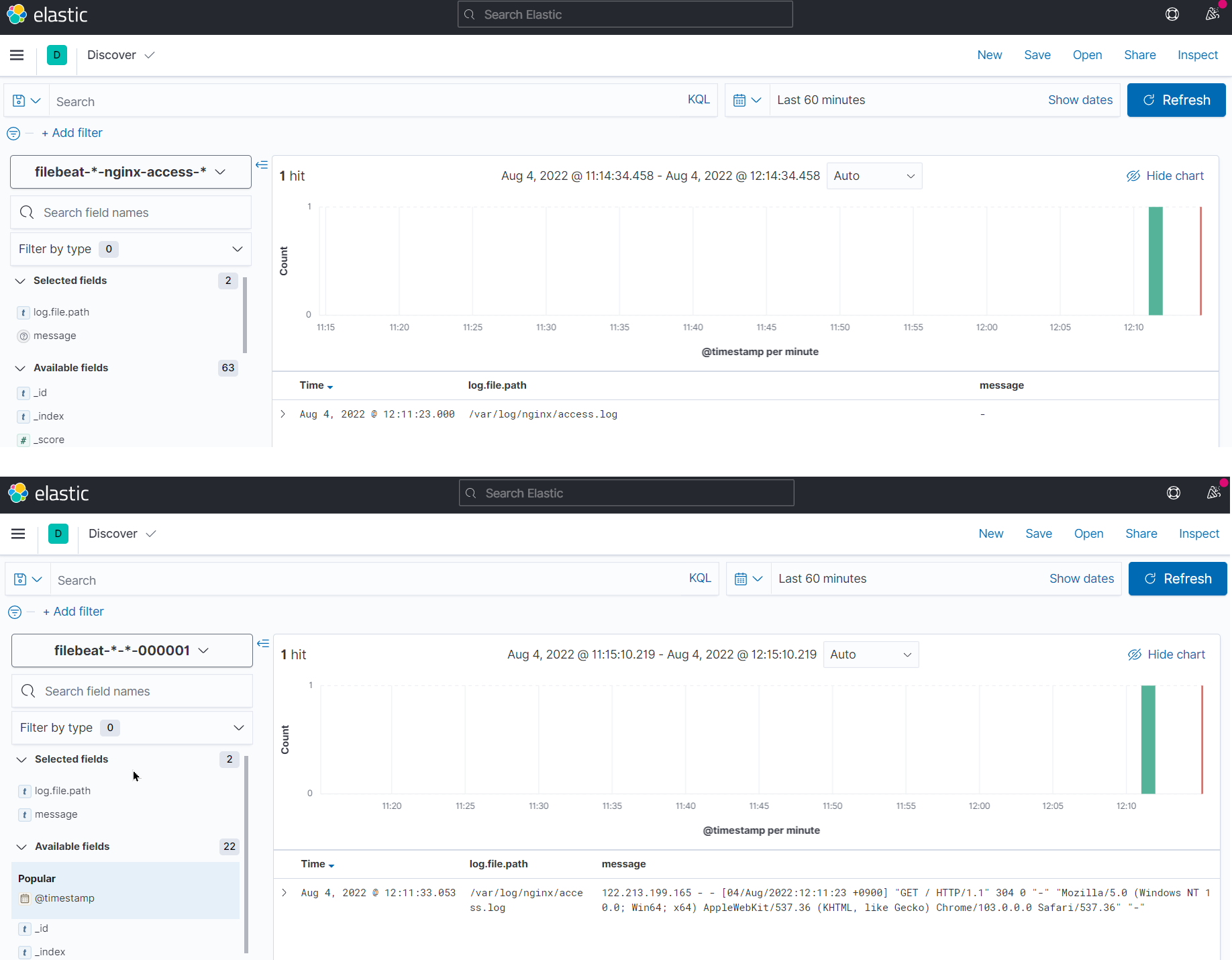

Of the indexes created, filebeat-7.12.0-nginx-access-2022.08.04 is the one described in filebeat.yml and is the one intended to be created.
However, filebeat-7.12.0-2022.08.04-000001 is created at the same time.
When I check these on Kibana, they both collect the same access logs.
Interesting and it looks like the default named index has the message field and the other does not...

The @timestamp is slightly off, but the ip, request, and user agent fields look the same.
As you can see with and without the message field, the way the fields are output is very different.
The filebeat-7.12.0-nginx-access-2022.08.04 has richer field entries, such as source.geo.location and traefik.access.user_agent.os_name, which parses the user agent, indicating that it uses Filebeat's nginx module.
However, the filebeat-7.12.0-2022.08.04 has simpler field entries.
There appears to be no parsed information, only an additional message field.

Ok that is good that means the module is working ... it actually pretty much means everything is working we just need to find out WHY the extra index is getting created / written too!
Actually it is not off ... the timestamp is the time of the actual event in the logs.. that is exactly correct, I can see that from the message...
We are close we just need to stop that other index... I am really really puzzled where it is coming from.. I can not reproduce

So you have 2 choices of architecture
  1. Filebeat-> Elasticsearch
    Probably what I would recommend.
    Use the ngnix for the nginx logs
    And us a normal file / log input and create and ingest pipeline in elasticsearch to parse your other logs.
    No logstash needed.
    If you shared a sample log line and the parsing you are doing in logstash we could probably create a ingest pipeline
  2. Filebeat -> logstash -> Elasticsearch..
    More complicated
    Use the ngnix moduled for the nginx logs and then point them to logstash which will work as a pass through.
    Collect the logs and parse them in logsstash and send them to elastic.
    This will require addition logic in logstash in the input and output sections.
Which one would you like then you should open a new thread on that
