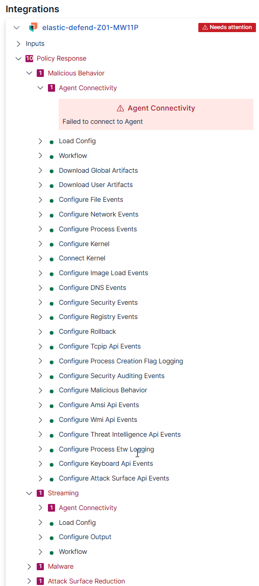

Fyi, it seems like FLeet does detect something is wrong, the state of my test Agent went to Orphaned.
.\elastic-endpoint.exe status
- elastic-agent
  - status: (FAILED) Not connected
- elastic-endpoint
  - status: (DEGRADED) Running
  - artifacts channel: default
  - policy
    - actions:
      - agent_connectivity: warning
        - Failed to connect to Agent
So luckily there appears to be some builtin monitoring of this situation.
