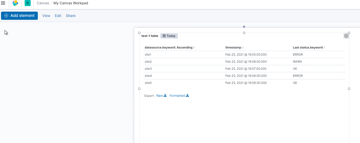

I have created a data table in Kibana and then imported it into Canvas.
I think this is the easiest way to achieve your results.
In canvas
Thanks for the suggestion. I ended up working around it by sorting by timestamp first. Once it's in the data table, I sort by the status field.
