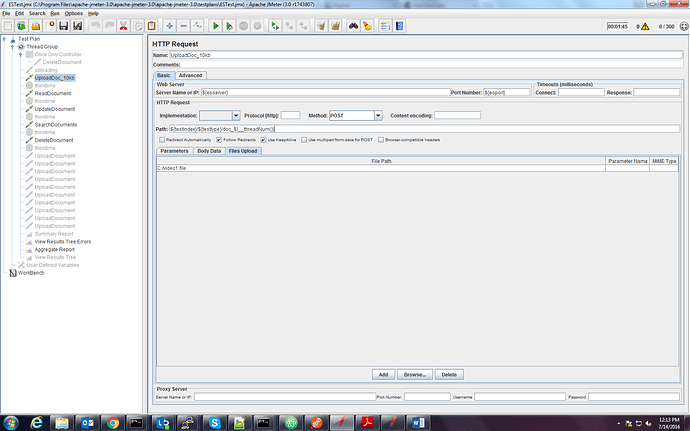

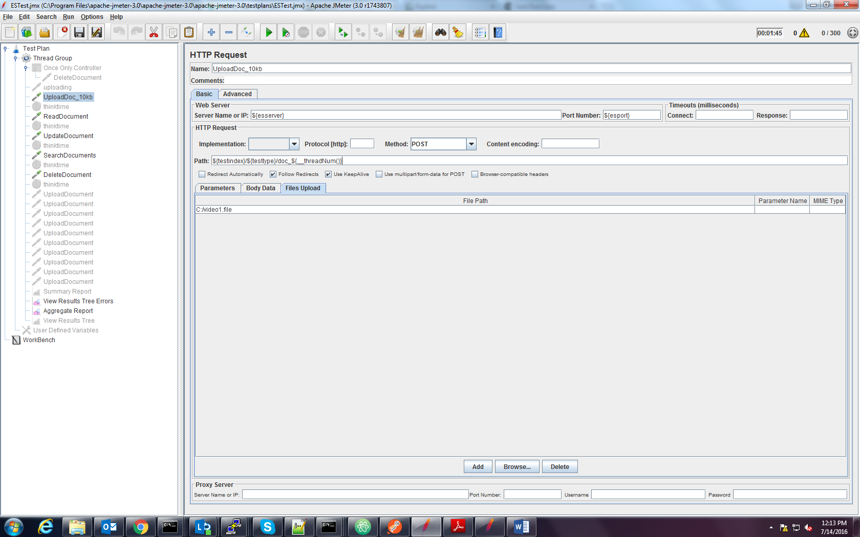

i am giving input in file upload space to node.js code from jmeter
Hi,
I guess you don't really upload C:/video1.file as indicated by your screenshot, right? :slight_smile:
How does the document look like and what is the problem? You wrote initially that you get "undefined" (where?). Sounds like a problem in your node.js code? Did you try indexing directly into Elasticsearch?
