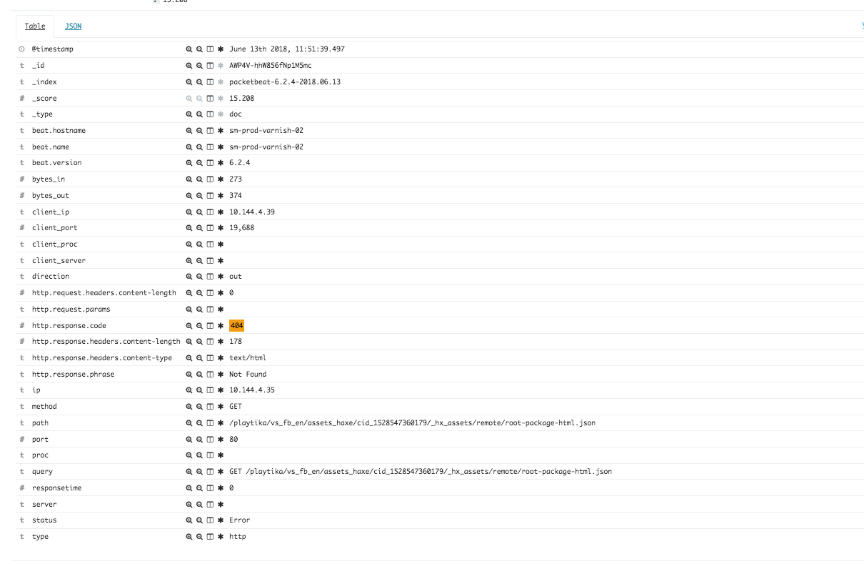

at the same time in kibana for packetbeat index:
http.request.headers.content-length |0|
http.request.headers.content-type |text/plain; charset=UTF-8|
http.response.code |404|
http.response.headers.content-length |178|
http.response.headers.content-type |text/html|
http.response.phrase |Found|
ip |10.144.4.37|
method |GET|
path |host/vs_fb_en/assets_haxe/cid_1527253507926/_hx_assets/remote/root-package-html5.json| port |80|
proc ||
query |GET /host/vs_fb_en/assets_haxe/cid_1527253507926/_hx_assets/remote/root-package-html5.json|

can you show an example of a request with --http1.1 that doesn't fail and its indexed as a 404?
32%20PM
