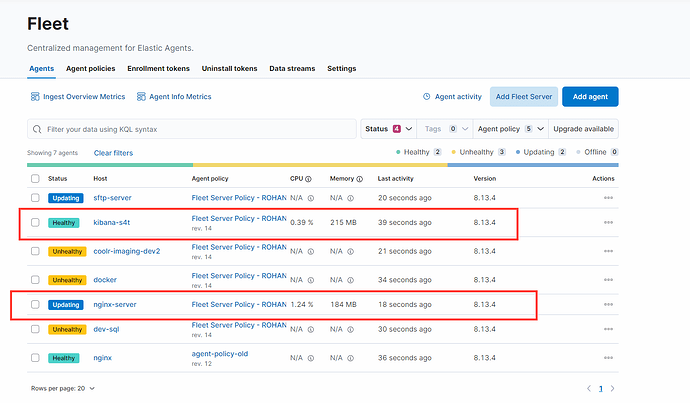

Agent is showing healthy but there no metrics
This the status showing on kibana dashboard Below are the machines that enrolled inside proxmox server using private IP
There is a thing like if I enroll a machine in fleet server internally and externally I am able to enroll
root@sftp-server:~/elastic-agent-8.13.4-linux-x86_64# sudo ./elastic-agent install --url=https://192.168.13.168:8220 --enrollment-token=token-here --insecure

Agent Policy under I am assigning new agents
Fleet Server Policy - ROHAN
rev. 14

ISSUE - I am not able to get metrics from the machines that enrolled outside the network (proxmox) what is the certificate verificate part I am missing? and How can I fix
