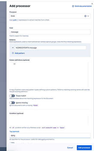

Inside elasticsearch I created such pipeline (with grok as preprocessor)
This is test grok pattern, so for all works I decided to use only greedydata.
But I don't know how can I create index from this pipeline.
In my understanding,
I have filebeat which sends logs with tags, ingest pipeline has pipeline with preprocessor with grok for logs.
