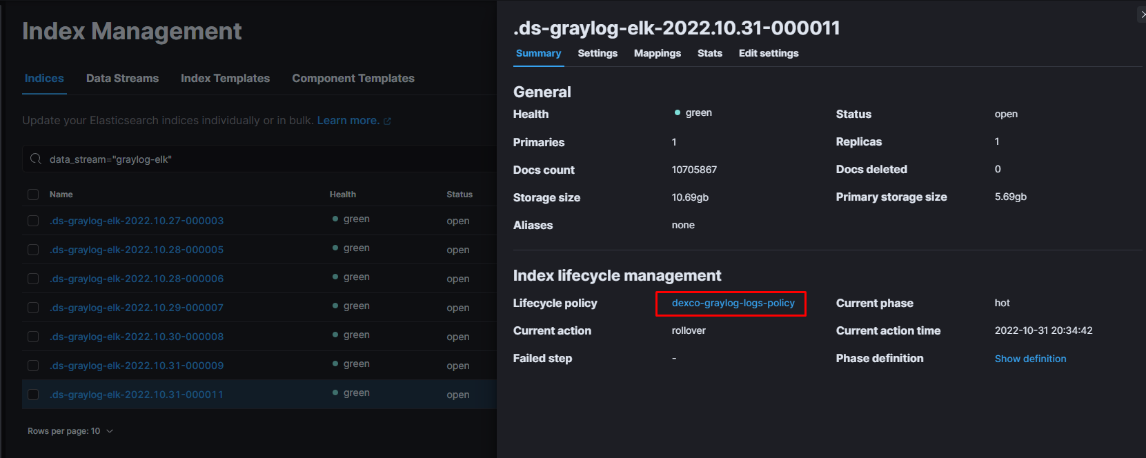

I attached (file datastreams-created.png) the list of datastreams that were created from a policy I changed:
I also attached (file datastreams-policy-applied.png) the ILM policy that was applied to all datastreams created:
Below is the definition of the "dexco-graylog-logs-policy" policy:

I would like to have an index rotation based on the age of 1 day maximum for each index, and after 5 days after each rollover made on top of each index, there would be a deletion of the oldest index.
Could you guide me how to do this? I couldn't quite understand how ILM works.
