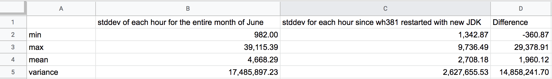

So, I updated to jdk1.8.0_111 on one of the problematic nodes, and gave it ~half of the shards it normally gets, and it has been fine all day. It will be starting off with a normal daily load of shards at midnight UTC tonight. The only problems I've seen appear to be related to the other problem node, but it's currently in our secondary data center which does orders of magnitude less traffic.
Will have a lot more data this time tomorrow, but I'm cautiously optimistic so far.
10
I feel pretty good about these numbers. There is natural variance in the incoming logs of course, so we're going to see movement on indexing rate, by this pretty much proves things have smoothed out considerably.
Thanks, David! Can't believe it ended up being just an upgrade from 102 to 111 on a single node, but what can you do?. I'll be updating all the rest as soon as I can.
