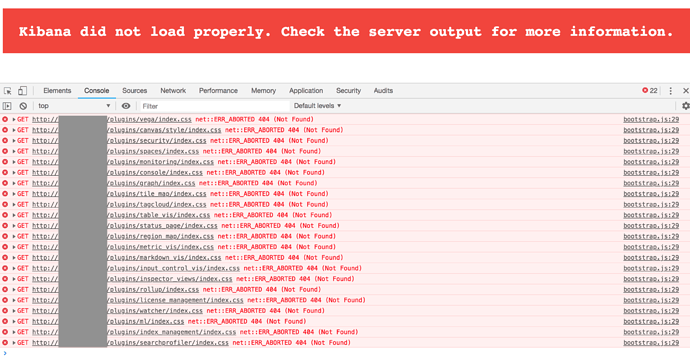

Installing ELK 6.5.1 results in Kibana web app not loading properly
I wanted to upgrade all ELK tools from 6.2 to 6.5.1, but I am encountering that same problem all the time, even if I uninstalled and installed all again, from chef cookbooks.
The problem is that Kibana web app http://127.0.0.1:5601/ cannot load some of its style sheets. I am getting 404 (Not Found) all the time.
Anyone knows what might be wrong?

Ok, so I've finally found out that the problem was missing right Apache configuration (reverse proxy entries) to pass the requests to Kibana webserver.
