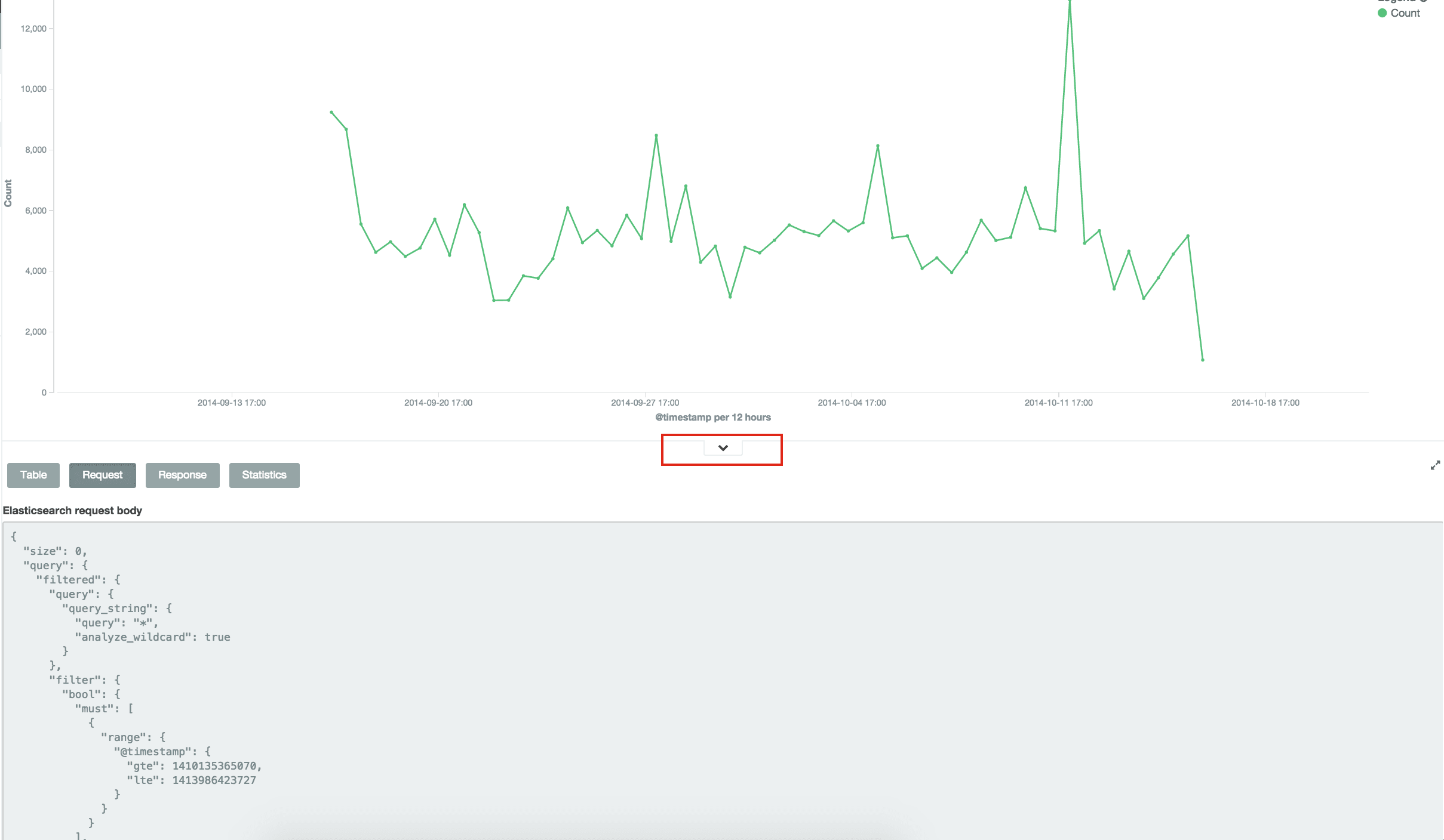

iFrames is the typical way we see Kibana charts being integrated into portals. Aside from that, you can build your own visualizations on top of Elasticsearch, using Kibana as a way to understand how to structure your Elasticsearch queries. Behind every chart in Kibana there is information about what request is being sent to Elasticsearch (see screenshot).

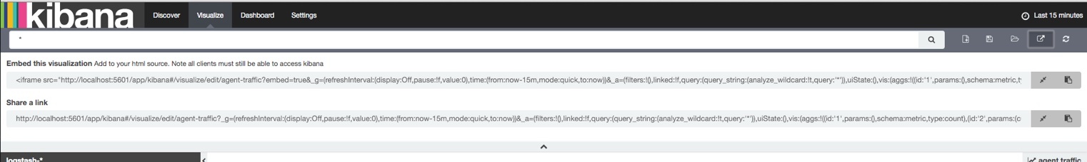

However, getting the iFrame code is pretty easy, it's under the share menu.
The first section contains the iFrame code you need for whatever you're looking at in Kibana.
If you look at the src URL, you'll see the complete state of the visualization or dashboard or whatever it is that you are embedding. Generally we see user embedding visualizations, and when they need to change the time range or something else in them, they do so by modifying the URL in the iFrame from within their application.
