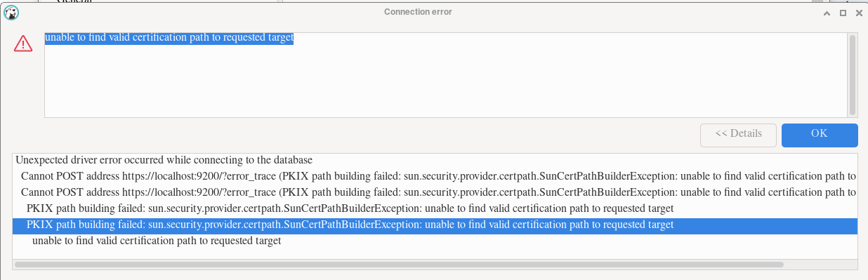

However, I'm getting this invalid cert error:

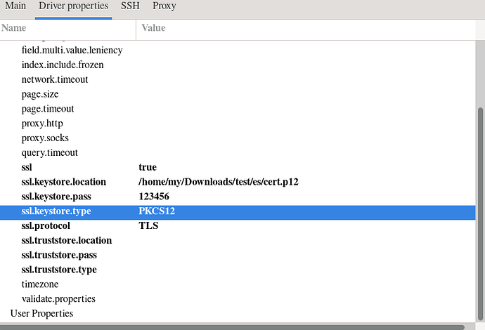

These are the driver parameters:
What certs do I need in order to pass the cert check? I wish there was an insecure flag to ignore the validation since it runs in localhost.

You have added the Elasticsearch certificate and key as a keystore in DBeaver. However, what you should be doing here is adding the certificate (or even better the CA) to DBeaver's truststore.
As @kpe has suggested, you should use keytool for this, but you might not want to add it to the JVM's cacerts.
You can do:
keytool -import -keystore elasticsearch.p12 -file /usr/share/elasticsearch/config/http-certs/ca.crt
And then in the DBeaver driver parameters, set ssl.truststore.location to point to your new elasticsearch.p12

I port forward connection from the k8s cluster to my desktop. At first when the DBeaver connected to the elasticsearch via jdbc:es://https://127.0.0.1:9200/ I got this error:
No subject alternative DNS name matching
I have to use jdbc:es://https://ES_NAME-es-http.default.svc:9200/ instead, and that requires adding that line to /etc/hosts. The ES_NAME-es-http is the service name of the es cluster, and default is the namespace where the service is located.
