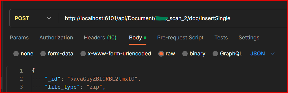

I changed my client side implementation to have a property named "_Id".
In the error logs i see, it is indeed mapped correctly.
But i get bad request 400 errors on bulk insert.
When i try a single insert using the 1 json doc payload, i get a 201 created response.
Elastic ignores the client side generated UUId.

I am confused ... this is not an Elasticsearch REST API Endpoint.
So, it is unclear how you are accessing Elasticsearch. Do you have a proxy or app in between?
Hi Stephen, i am using the nest chsarp library like so:
single doc:
many docs:
The NEST sdk confers the c# logic above to a low level client which in the end talks to the ES API. Does this clarify my usage?
