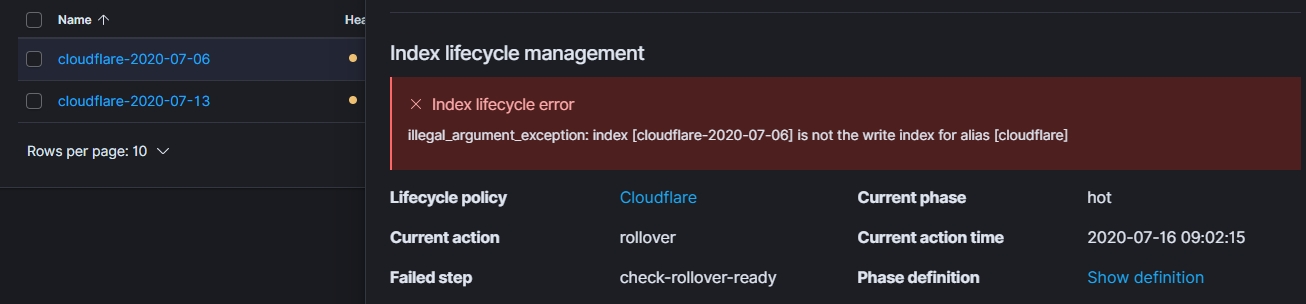

Once I did that, I started seeing the following 2 errors (1 on each index):
I'm not sure why the "is not the write index" error is showing up on the older index. Perhaps this is because it is still "hot" and trying to move it to another phase without it being the write index?
For the second error, is this because the name of the index is wrong for rollover?
