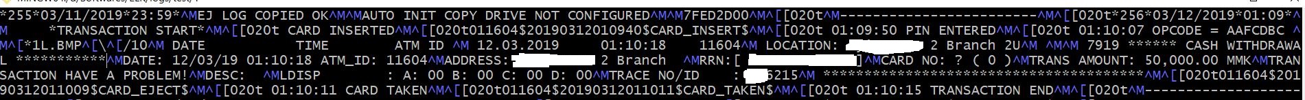

I am trying to read some custom logs. I am using multi pattern as well. The file is containing only \r or ^M as line terminator. I tried with line terminator configuration auto and carriage_return as well. But the file is not getting read by file beat. Below is my configurations. Appreciated any help or inputs. Attached the snapshot of sample log file as well.

Apart from that is there a way to read files with only \r as terminator?

The context is I am reading ATM generated logs and analyzing it. So the feasibility of asking them to put \n instead of \r is nill.
