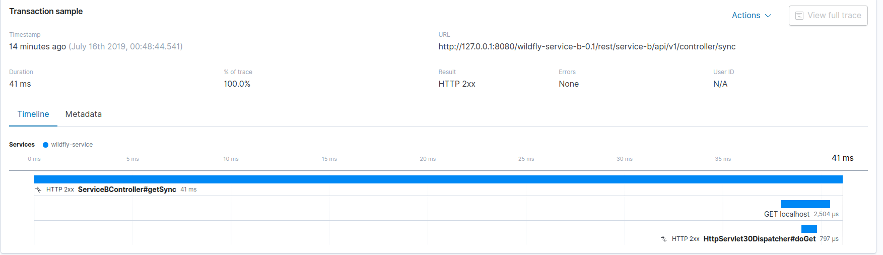

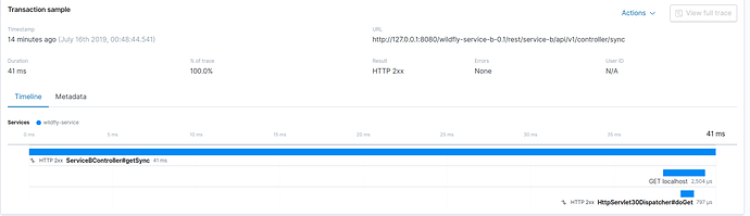

Have a Simple test scenario SeriveA:method1 -> SeriveB:method1 -> SeriveA:method2.
But if I change the call to ServiceB:method1 to async via
client.target("http://localhost:8080/wms/backendapi/serivceB/method1").request().async().get().get();
then the trace look like shown below:
So the trace is not propagated
I am using the latest 7.2.0 Stack and apm java agent 1.7.0

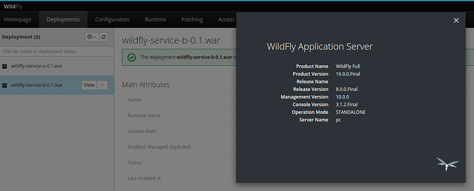

I failed to reproduce your problem again:
I tested on wildfly 16
added 2 simple projects and deployed to server:
service-b-wildfly
service-a-wildfly
