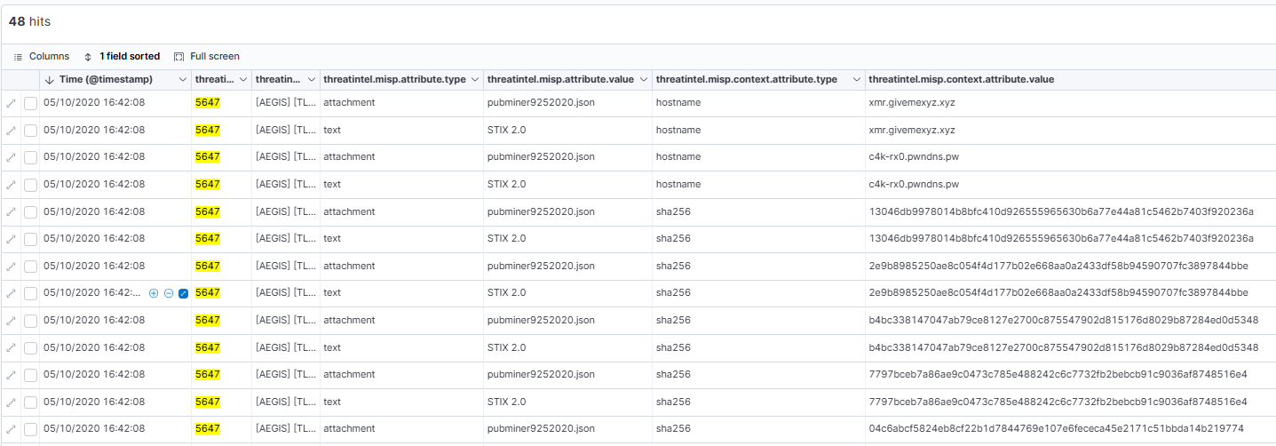

However, the problem I'm facing now is that MISP events with objects are not treated correctly in the input phase.
For example, a MISP event with 26 attributes (24 standard attributes and 1 object with 2 attributes) is ingested to 48 elastic documents: the single values mapped to threatintel.misp.context.attribute.value, and duplicated for each one of the attributes of the object.
Flat MISP events are handled as expected (1 elastic document for each MISP attribute belonging to the event)
