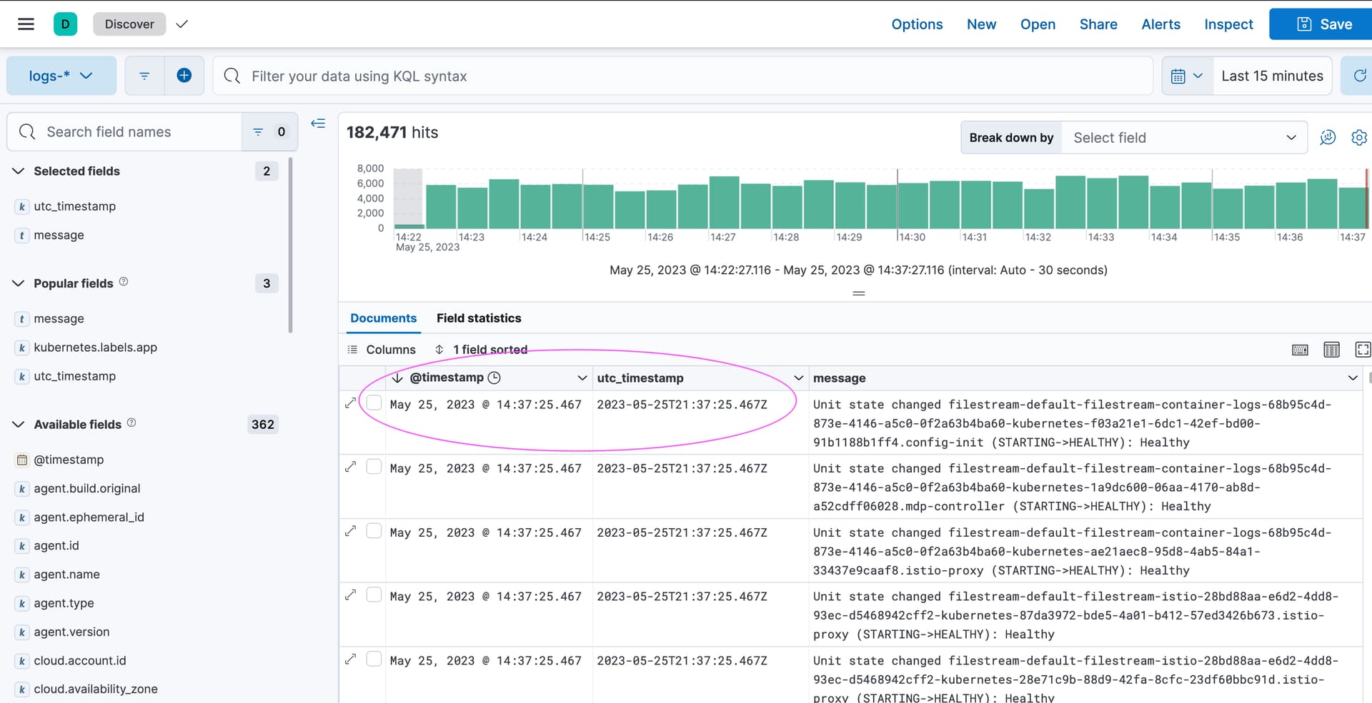

There is a pretty quick way you can see both assuming you are on a fairly recent version of Elastic / Kibana. What Version are you on?

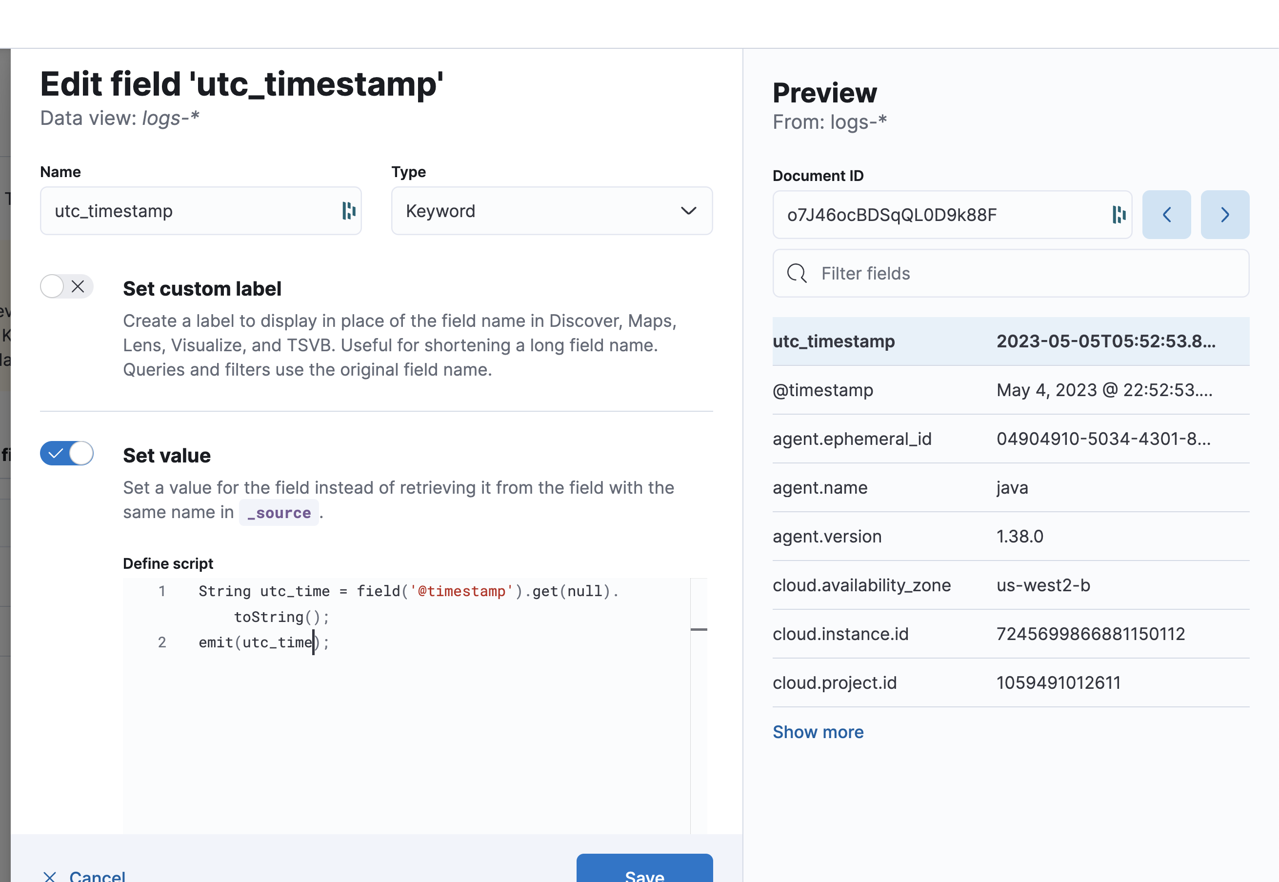

In short, Leave Kibana in Browser Zone and you can add a runtime field that will always show the UTC Time as a string and it will be available in Discover as a string, would that help?
