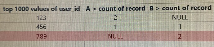

Thank you for the response!
Right now my table visualization looks like this:
is there a way for me to not show a user_id if it only has an operation: “b” log?
So In that case the red row in the example photo would not appear in the table
