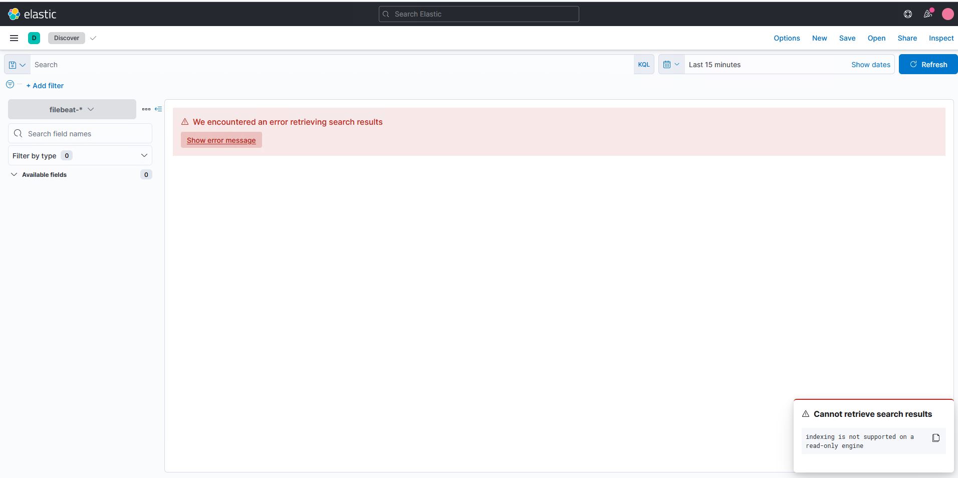

Hi,
I have an issue with KIbana Disocver module. I cannot search in my indices. The error I see is : "indexing is not supported on a read-only engine". All my indices are with status green.

Any idea what might be the problem?
PrintScreen with the error.
Regards,
Here are some error logs from kibana.log:

That looks relevant. Can you try restarting Kibana?
Hi Warkolm!
Yes I did, but it didn't help. I even restarted Elasticsearch service.
Thanks!
Ok, stop Kibana, issue a delete on the .kibana-event-log-7.14.2 index/alias in Elasticsearch and then restart Kibana.
Thanks Mark Walkom!
Problem solved. I deleted all the .kibana indices, restarted kibana and unfrozen some system indices and it worked. Additionally I flushed and cleared the cache of all the indices.
