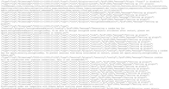

After installing Inhanced-Table plugin, my Kibana is stock on following message
  "Kibana server is not ready yet"
However after some minutes it completely became out of reach and I face with "Unable to connect" error on my browser.
I removed the plugin with following command but the error still exists.
./bin/kibana-plugin remove enhanced-table
Would you mind helping me in order to solve this problem. Also Kibana logfile is available via following link.
Thanks Best Regards
