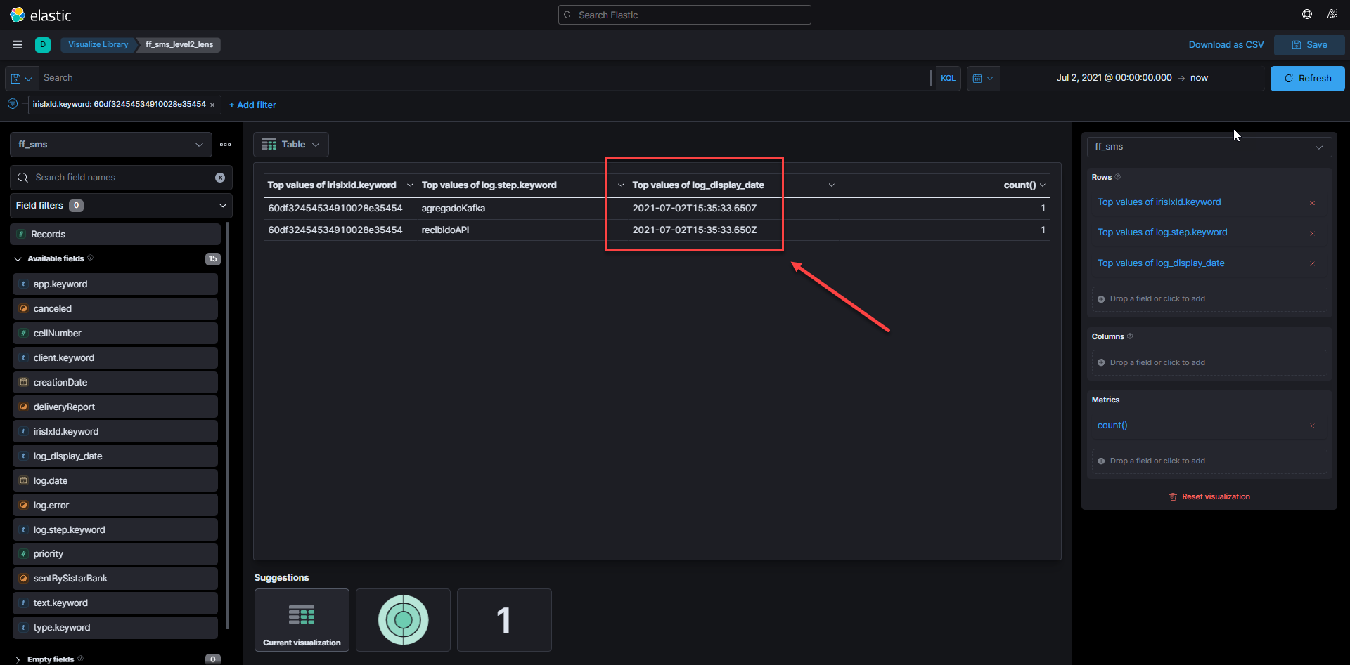

Hi, using a table in Kibana Lens I can't get a formatted date at the "Log Date" column. The date format changes according to the time period. Below is the JSON I've been using and the screenshots with the issue

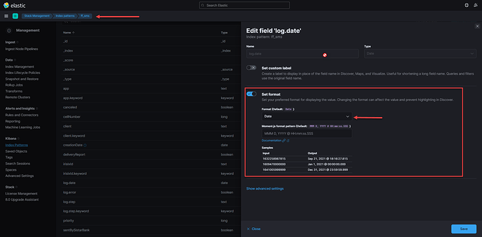

There is another method to do this... Set the date format pattern for that field in its index pattern, and that will only affect the display for that field wherever it is used.

I changed in "Advanced Options" the date format mask (to DD-MM-YYYY HH:mm:ss) and the date column shows the correct format, but not the correct value. If you take a look at the JSON, the first two rows shows wrong minutes and seconds, ie., 02-07-2021 12:00:00 (-03:00 GMT) is not equal to 2021-07-02T15:35:33.458Z. Take a look at the image below:

Thank you Stephen for your response.
I also changed the date format at the pattern field, but the result is the same as the screen at the previous post, no change.
The only way I found to get the right date vale was to create a scripted field like the image below:
