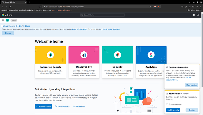

Kibana loads default elastic page instead of setup
I am using filebeat with elk on an ubuntu server VM. When I visit the server's ip from the host machine this is what I get:
How do I go to the kibana setup/login page?

PS - my VM is in NAT and host-only network mode
Hello @Palak_Chopra
As it says in the pop-up on the right at the bottom, you need to activate security on elasticsearch.
Here is a link that may help you : https://www.elastic.co/guide/en/elasticsearch/reference/current/configuring-stack-security.html
Hi @Palak_Chopra Welcome to the community.
Apologies, I'm a bit confused. What Kibana setup page are you talking about?
What are you trying to accomplish?
@ahmed_charafouddine is correct. You do not have security enabled so there is no login screen....
Thank you! I totally skipped over this during installation.
I was getting a default elastic page instead of the setup one that comes when you first access kibana.
@ahmed_charafouddine 's answer helped!
