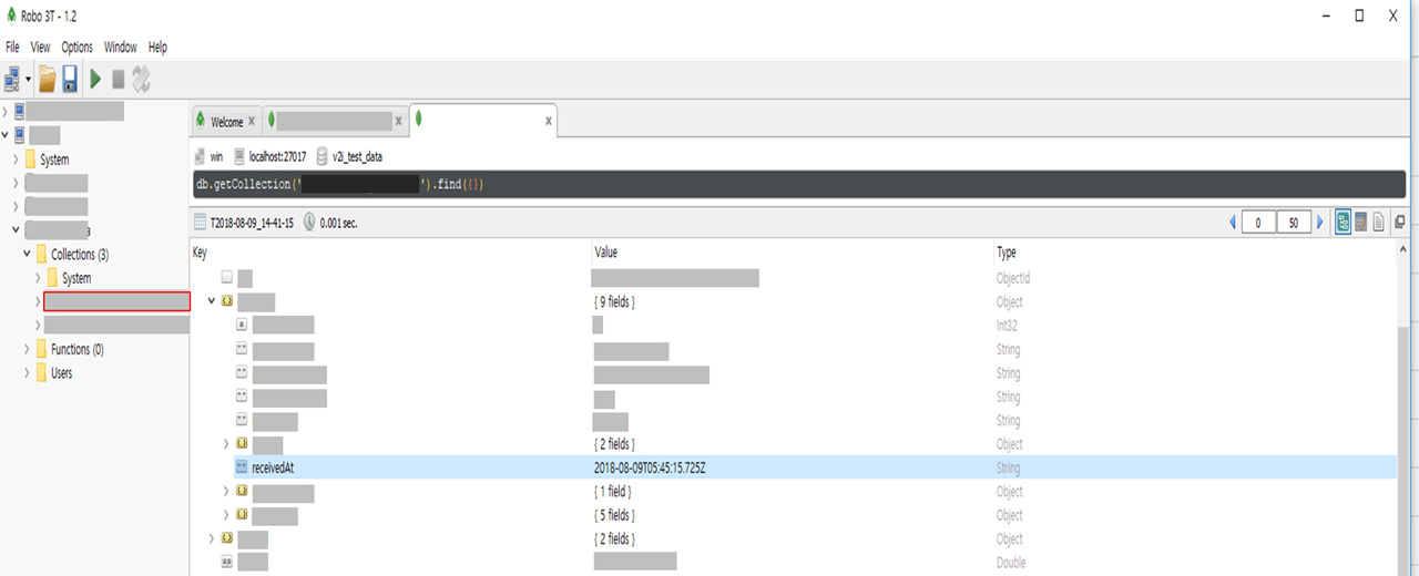

My data based on MongoDB like below
I uploaded data to ES and type check also 'Date'.
