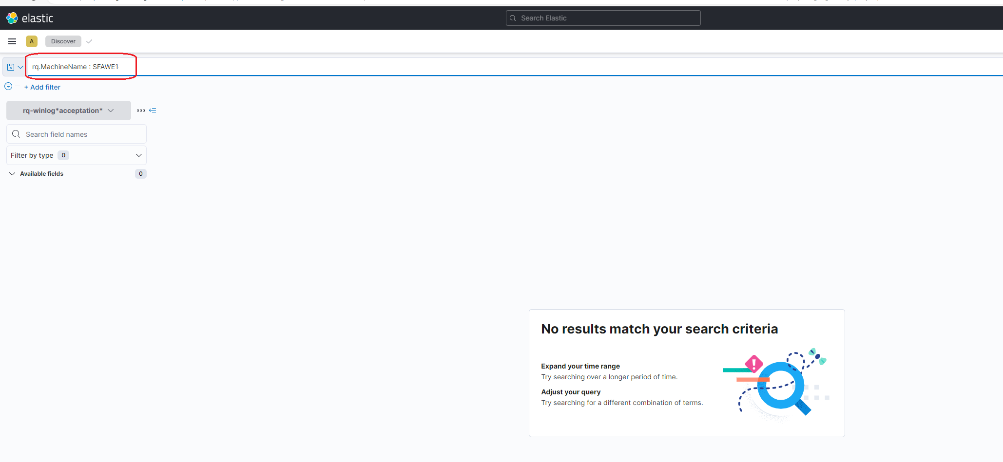

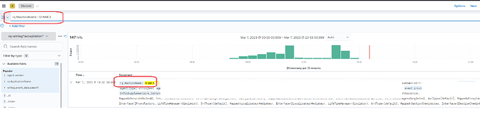

Hi,
From KIBANA-Discover Onglet, we unable to search event log windows with our custom variables/pattern , agent beat used is Winlogbeat,
this issue is appear just in two server, for other server we don't have this issue
exp our customer variable : rq.machinename
Picture 1 : issue
Picture 2 : No issue
error identify in log agent Winlogbeat :
2023-03-07T14:38:42.398-0500 ERROR [logstash] logstash/async.go:280 Failed to publish events caused by: write tcp 172.30.169.11:62412->172.30.230.23:5044: wsasend: Une connexion existante a dû être fermée par l’hôte distant.
2023-03-07T14:38:44.053-0500 ERROR [publisher_pipeline_output] pipeline/output.go:180 failed to publish events: write tcp 172.30.169.11:62412->172.30.230.23:5044: wsasend: Une connexion existante a dû être fermée par l’hôte distant.
