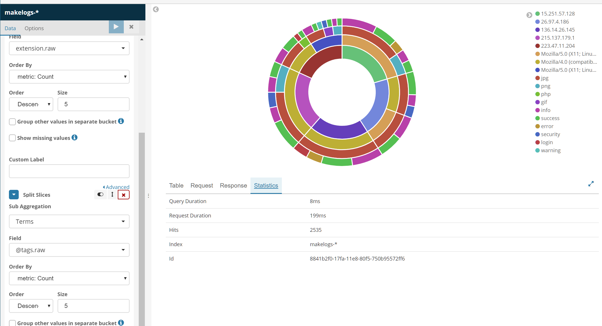

I just created this Pie Chart on the latest 6.2.2 release and its loading quite fast;
Can you look at the statistics and show them here?
Also can you describe the types of aggregations you're doing in it? Mine were all Terms aggregations.

Well, my donut is more of a 100-100-100-100 rather than the 5-5-5-5 that you build in the test. In reality less would do, but thats the definition. In full screen it makes sense in Kibana 5.6.4.
As complarison Kibana 5 does the trick with "endless" layers and buckets and also lightning fast. We found that Kibana 6.1.2 worked with very small donuts like yours, but then still noticeably slow.

Similar issue to report - small data set, layered donut, and the 3rd layer already slows things significantly, while layer 4 is completely halting the UI. It must be doing recursion calculations, but I would expect the slowness to be detached from the UI, and as mentnioned by the original poster - a small dataset is being used, and still it's performing badly. FYI.
I discussed this with the Visualization functional group in the Kibana team and they said there was a performance issue that was fixed in 6.2.0. If you can, please try to compare (the latest release is 6.2.2).
