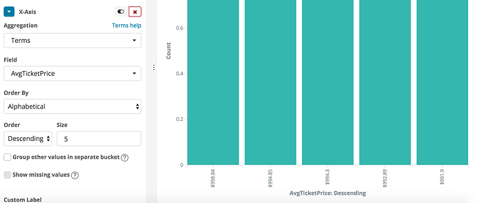

What's the order by on the bucket? It's probably ordered by count when you want it to be Alphabetical. Well, alphabetical ordering usually doesn't work on a numerical field, but maybe it's smart enough to acommodate. I haven't tested. Give it a try and let me know if that works for you!
Week is order by "metric:count". Week is stored as number, so order by count should work.
Order bymetric:count is actually going to order based on the y values, not the x values. It's just not obvious because they are split up, but it does something like sum up all the values.
See how here the x values are not in alphabetical order but ordered by the y axis count.
Here they are sorted alphabetically (which also happens to be desc on count too)
