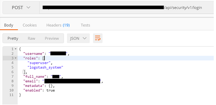

This is how i call login: This code generated by postman, where i can call login succesfully.
Response to this call :
{"statusCode":404,"error":"Not Found"}
Response for preflight has invalid HTTP status code 404
Postman response:
