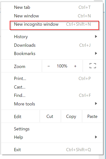

I've seen a case where a user can't log in to Kibana because of some cached data in the browser. One way to see if that's causing you problems is either to try logging in to Kibana in a browser where you've cleared all cached data. Another way is to open a new private window.
In Chrome its New incognito window
In Firefox it's File > New Private Window
In Internet Explorer 11 it's Tools > InPrivate Browsing
