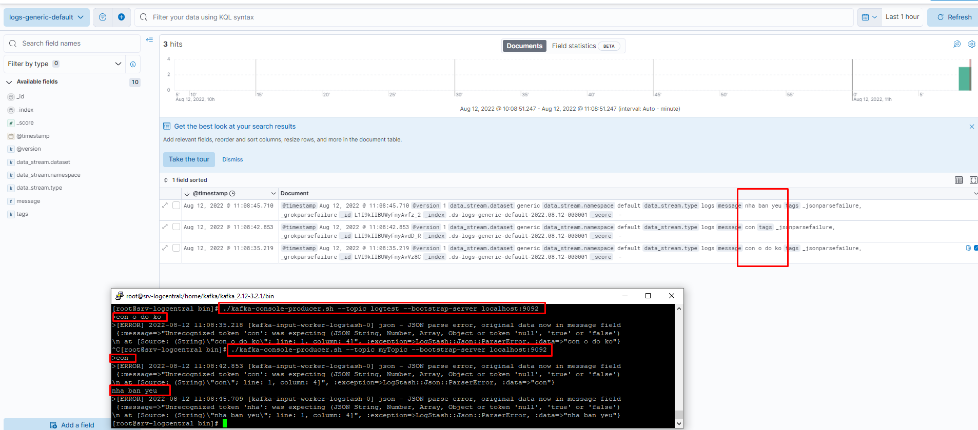

About architecture, I firstly installed filebeat on Windows to get logs from there. then I want to use it to output log to kafka, and from kafka to logstash. Finally from logstash to elasticsearch.
Just like the image below
However, I'm having problem with not seeing logs from kafka/logstash (from Windows filebeat) on Kibana.

When i do test kafka
  • ./kafka-console-producer.sh --topic logtest --bootstrap-server localhost:9092
  • ./kafka-console-producer.sh --topic myTopic --bootstrap-server localhost:9092
    I do see both of 2's output on Kibana portal.

@leandrojmp Yup, i feel the same thing. I'm not sure if i config filebeat on Windows correctly, I have changed path as you said but still have no result. Here is the message.
Please don't post images of text the are really hard to view and help you with, they can not be searched, copied, debugged and some people can't even see them
it looks like you are harvesting files....
BUT I do see that is looks like all / most events are failing... I think your filebeat is not writing to Kafka...
Please no more screen shots of text... I had to Zoom it just to read it!
