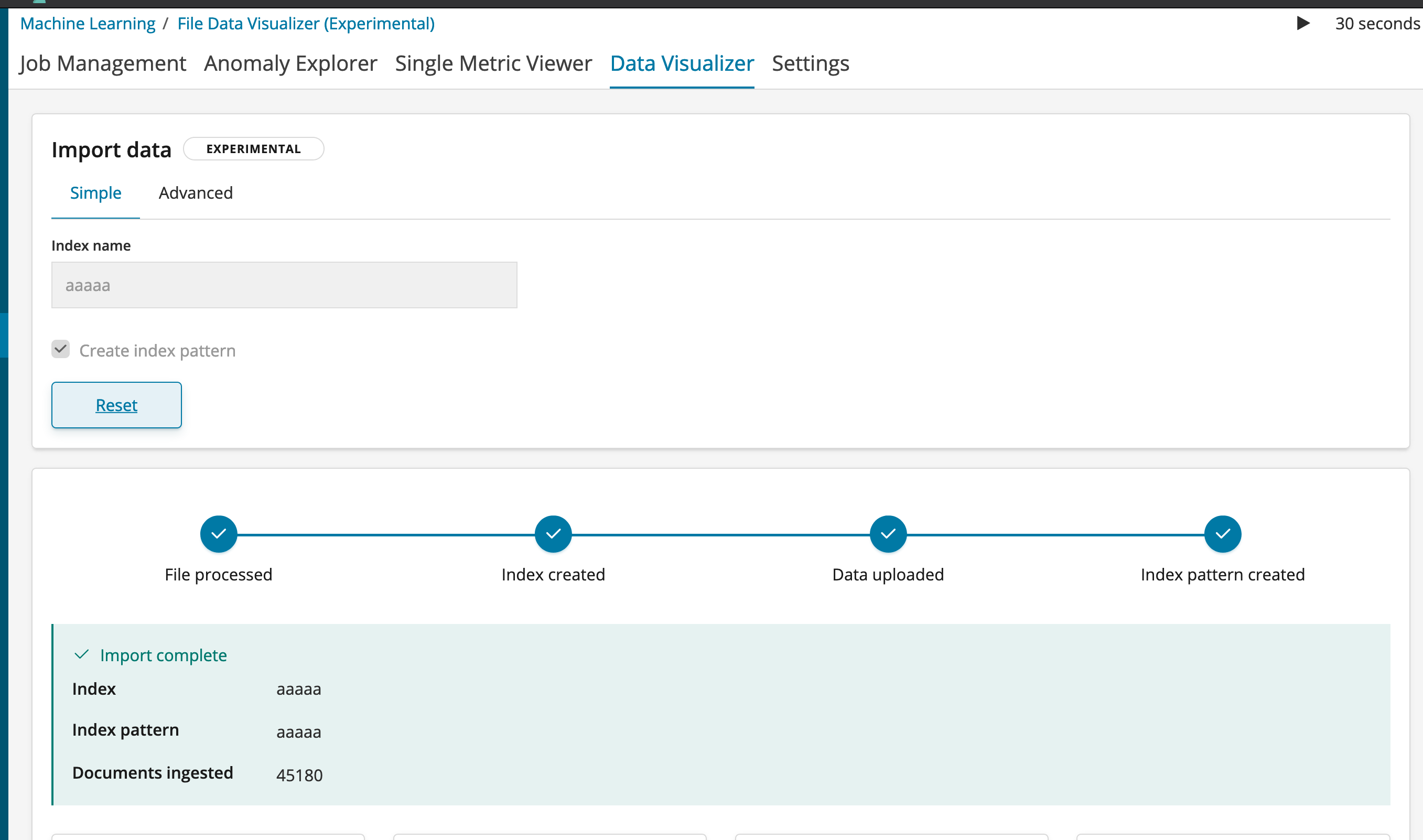

Thanks! Was able to download the file and it imported perfectly!

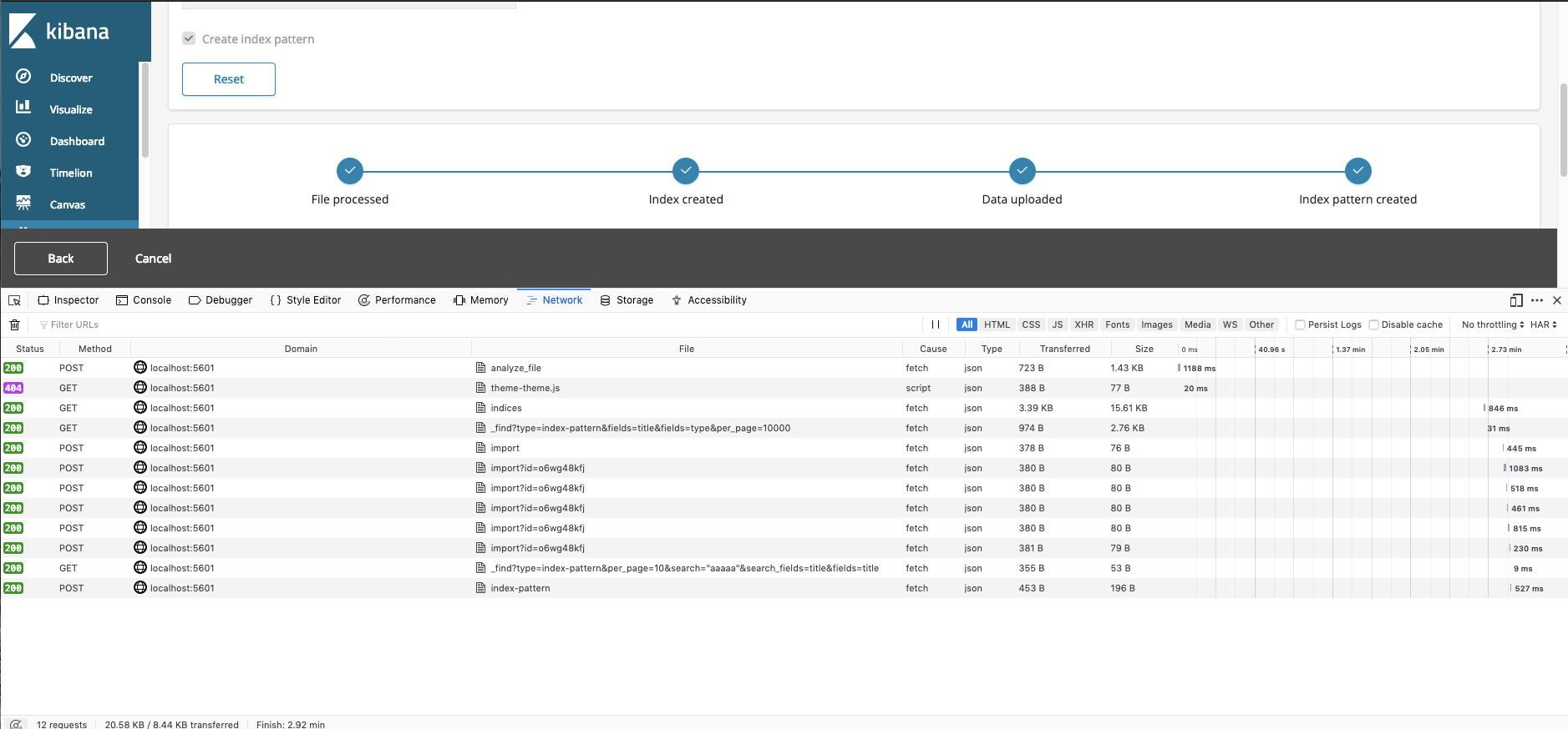

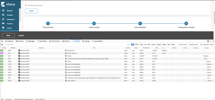

As you suggested, I opened the network console of my browser and I've found the issue
Nothing about Kibana but our network, I've got the 413 http status - Request Entity Too Large
