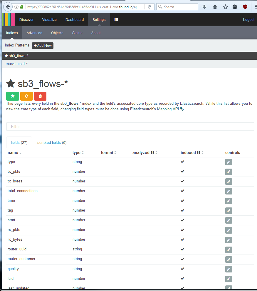

title isn't shown there either:
Viewing that settings page also shows this in the developer console:
Error: [illegal_argument_exception] Mapper for [title] conflicts with existing mapping in other types:
[mapper [title] has different [index] values, mapper [title] has different [omit_norms] values, cannot change from disable to enabled, mapper [title] has different [analyzer], mapper [title] is used by multiple types. Set update_all_types to true to update [omit_norms] across all types., mapper [title] is used by multiple types. Set update_all_types to true to update [search_analyzer] across all types., mapper [title] is used by multiple types. Set update_all_types to true to update [search_quote_analyzer] across all types.]
