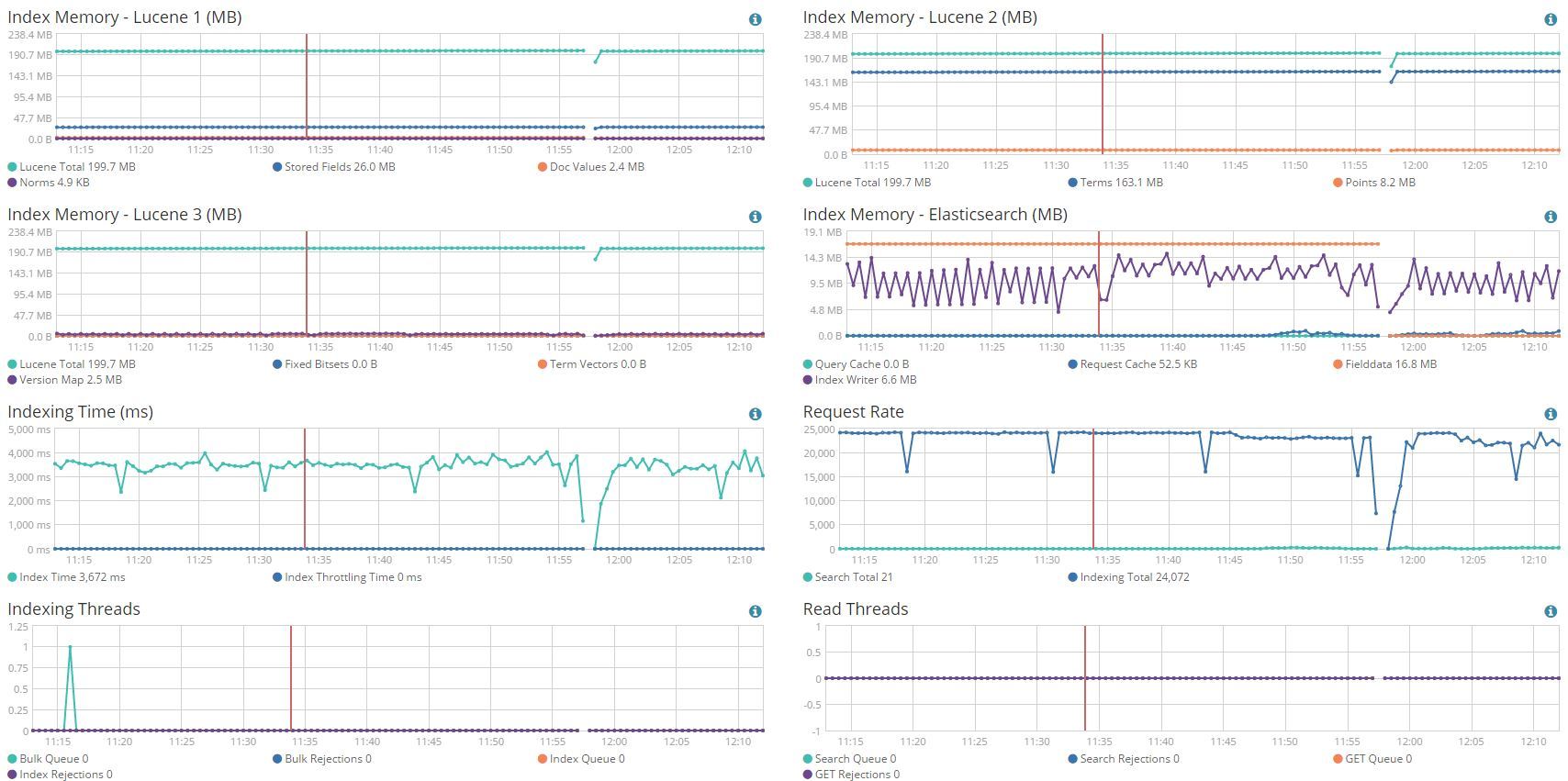

When I sent Traffic from one Device to elasticsearch, my traffic data looks like this:
When I add 19 more devices, my traffic drops. Every other device should send as much traffic and packets as the single device:
Here some other comparisons (Left side is 20 devices / right side 1 device):
You can see that the index rate and the flows over time value do not change,
although there should be much more data.
Elastic vs dev/null:
When I try to send all logs to dev/null rather than to elasticsearch my event rate changes (left side to elastic / right side to dev/null):
Do you have any ideas, what could be my bottleneck?
The CPU is only at 25% and the ram isn't fully used too.
