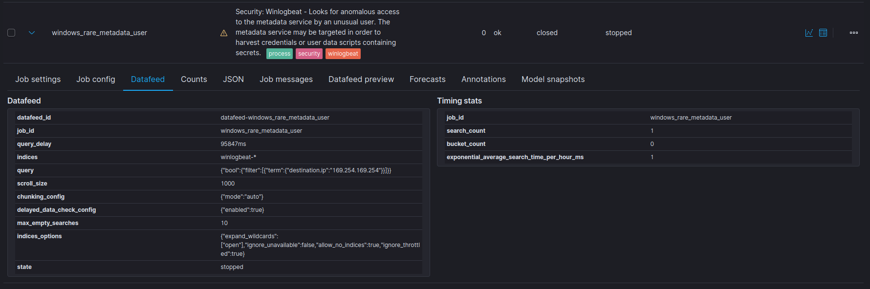

Here is an example of the datafeed configuration of one of the jobs that are not working, and as it's shown in the picture bellow, it is searching data in the right indice winlogbeat-*,

The query of the windows_anomalous_script job is:
GET _search
  "query": {
    "bool":{
      "filter":[{
        "term":{
          "winlog.channel":"Microsoft-Windows-PowerShell/Operational"
and for the 2 others jobs is:
GET _search
  "query": {
    	"bool":{
    	  "filter":[{
    	    "term":{
    	      "destination.ip":"169.254.169.254"
Could you please tell me why I am not getting results for the first job, and why in 2 the other jobs the query is searching just for that IP address ??
This relates to PowerShell scripts. If you don't use PowerShell scripts it's not surprising you don't have any events containing this field.
169.254.169.254
This is the address of the metadata service that's available in Azure and AWS - see Azure Instance Metadata Service for virtual machines - Azure Virtual Machines | Microsoft Learn and Retrieve instance metadata - Amazon Elastic Compute Cloud. If your servers are not in Azure or AWS then, again, it's not surprising that you don't have events that contain this IP address.
I can see that we should try to make the user experience nicer when there is a set of ML jobs and it's expected that some of them won't have any input data and others will. I will take this up internally. For the time being I would suggest you just stop those jobs that aren't relevant to your environment so that they don't use up any resources. Just leave the 5 open that are relevant to you.
