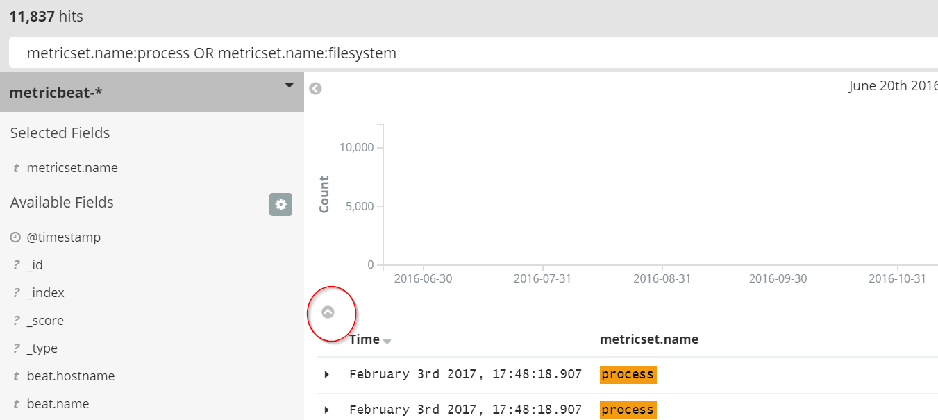

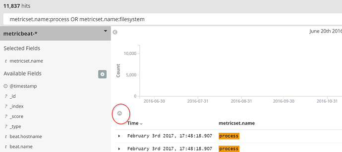

If you do your query in Discover tab like below, and then click the little ^ arrow to get to the "spy panel";
Then click the Request button;

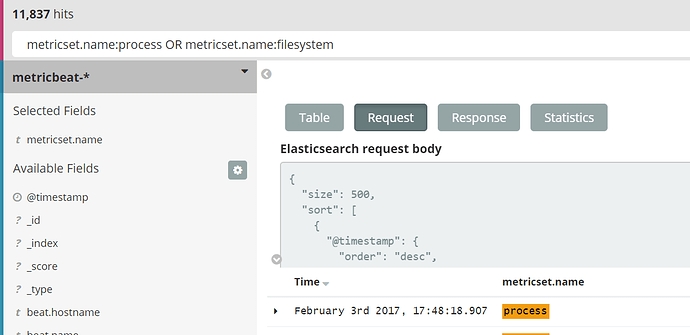

Then you can see the exact query that Kibana ran;
"query": {
    "bool": {
      "must": [
          "query_string": {
            "query": "metricset.name:process OR metricset.name:filesystem",
            "analyze_wildcard": true

You should be able to remove the time "range" block and the empty "must_not" block and get to something like this;
"query": {
    "bool": {
      "must": [
          "query_string": {
May not need the "analyze_wildcard": true part either.
So this is a little different than my previous screenshot which used a bool should, with 2 separate match_phrase blocks and a minimum_should_match: 1
This one generated by Kibana Discover is a bool must with a single query containing the OR
