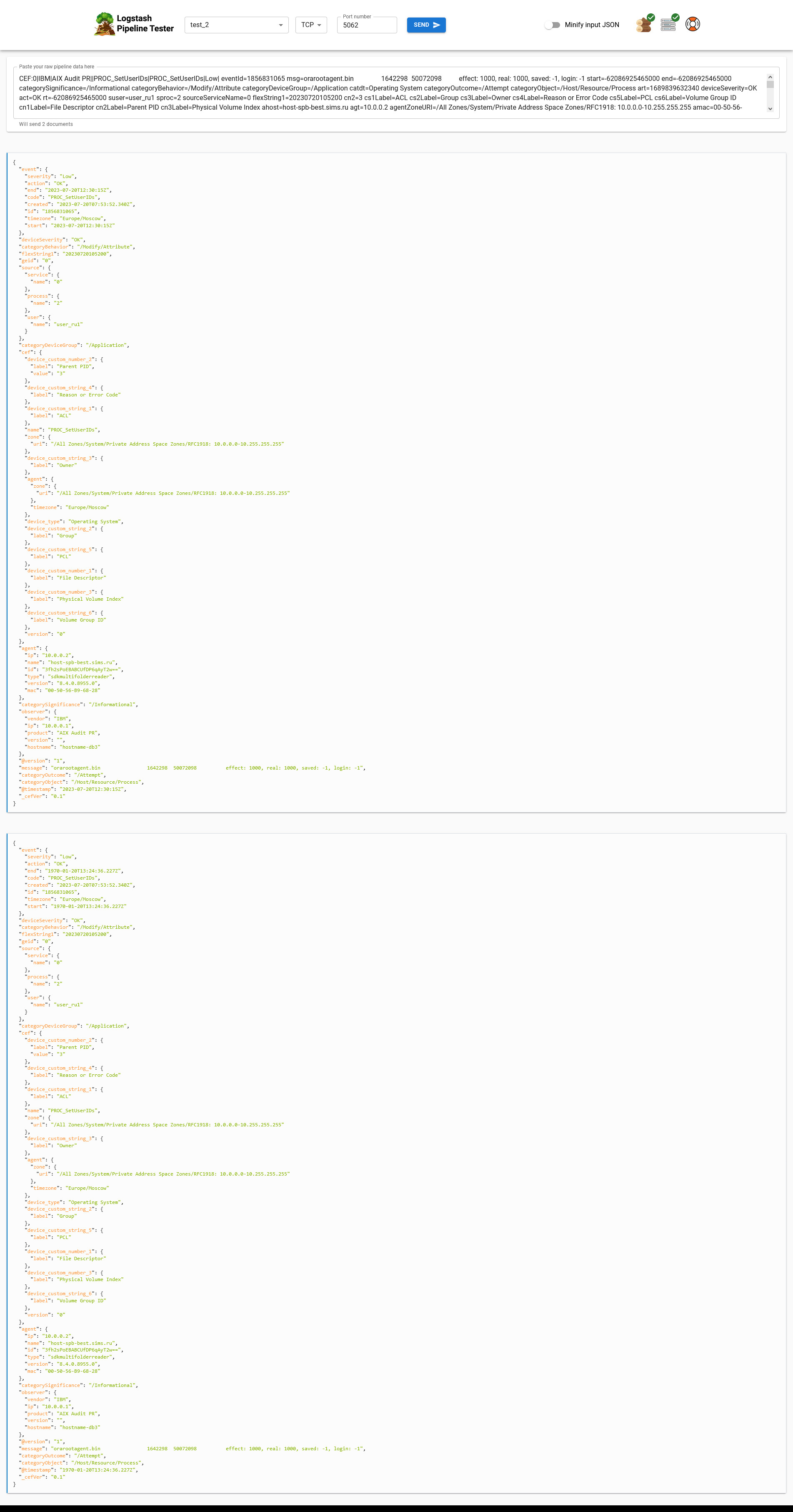

Bug screenshot:
I do not understand the reason, but note that in your screenshot it says "Will send 2 documents", so it seems to be telling you that it will break the line up.

For sure it says so, cause in the input there are two CEF strings to work on. I've attached them in the first post.

Please, pay attention to the string with broken parsing error case. Input string somehow was divided in half.
Screenshot_1
And where this was divided in half? Logstash will not do that unless you configure a split filter.
