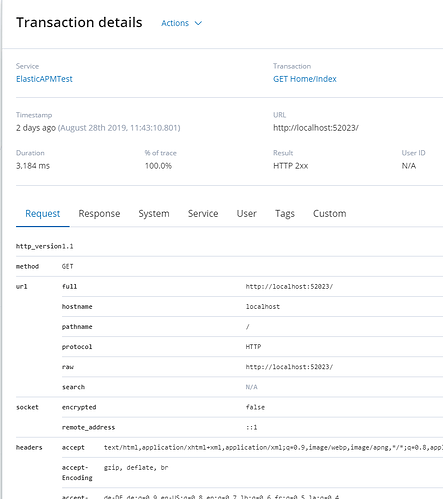

I am trying to get Database statements from the APM Stacktrace as shown in Greg Kalapos video YouTube i am following the instructions in the video and on the github page but only see the http request in Kibana.
screenshots attached
Do i need to configure the APM to send Database statements?

Hi @marcus.labohm
Greg here from the video :slight_smile:
In case you turn on the agent with the UseAllElasticApm method from Elastic.Apm.NetCoreAll you don’t need to configure database monitoring, we turn on everything for you. Now 1 reason you don’t see database calls can be related to this. Back in the alpha and pre-release days (that’s when the video you referenced was created) we had the UseElasticApm both in the Elastic.Apm.AspNetCore and also in the Elastic.Apm.All namespace. The 1. only turned on ASP.NET Core monitoring, the 2. turned on everything (ASP.NET Core, outgoing HTTP tracing, and database tracing, etc.) It turned out that having the same method name is very confusing so we made a change: Now there is the Elastic.Apm.NetCoreAll package with the Elastic.Apm.NetCoreAll (previously Elastic.Apm.All) namespace and it has a UseAllElasticApm method - an example usage can be seen here. Hopefully this naming is more clear: this is the one that turns on everything (including db monitoring). So my 1. idea: Do you use this method - (so UseAllElasticApm from Elastic.Apm.NetCoreAll)? If not please make sure you switch to this.

Hey Greg,
thx for the fast reply. You were right i did use the "UseElasticApm" Method in my code.

Hey Grey,
i finaly got some time to test this and it works like expected. :slight_smile:
So with the UseAllElasicApm method i am able to get the Databse statements from the DevArt dotConnector connecting to the Maria DB.
