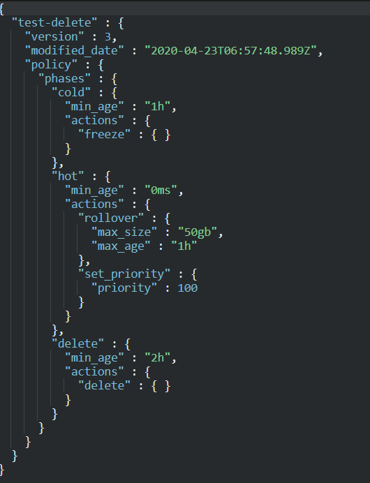

New index create by policy DOES NOT APPLY the POLICY
The problem I met is the same as the topic.
For more detail is that,
Can anyone guide how to use this function?

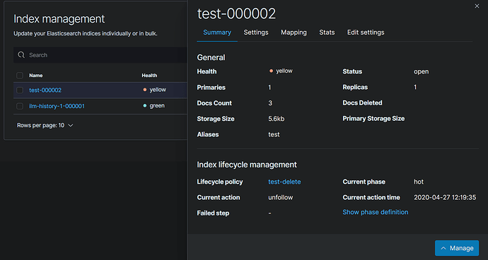

When you created the index, you set the index.lifecycle.name setting to the policy you wanted to use, but when the index rolls over, it looks like this isn't being set.
You need to create an index template that matches your index (test-*) that adds the index.lifecycle.name and any other related settings.
Template documentation is at https://www.elastic.co/guide/en/elasticsearch/reference/7.6/indices-templates.html
Thanks! It works.
