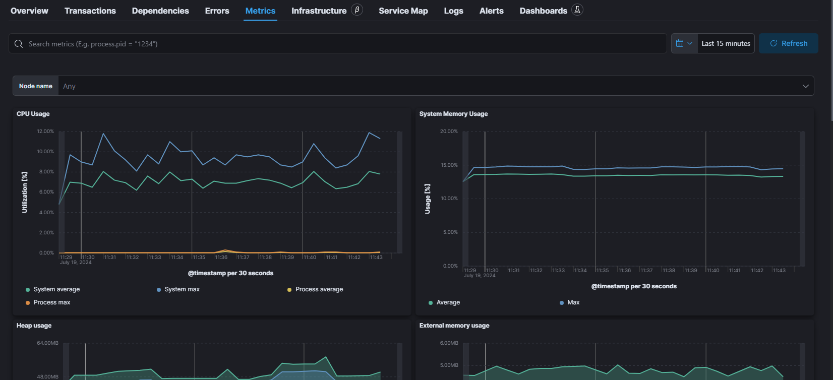

Description of the problem including expected versus actual behavior. Please include screenshots (if relevant):
I cannot see any transaction, but I can see the metrics
