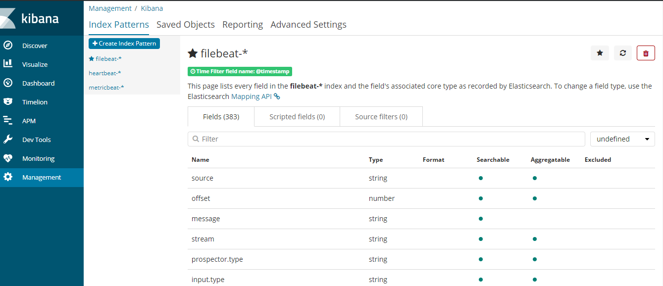

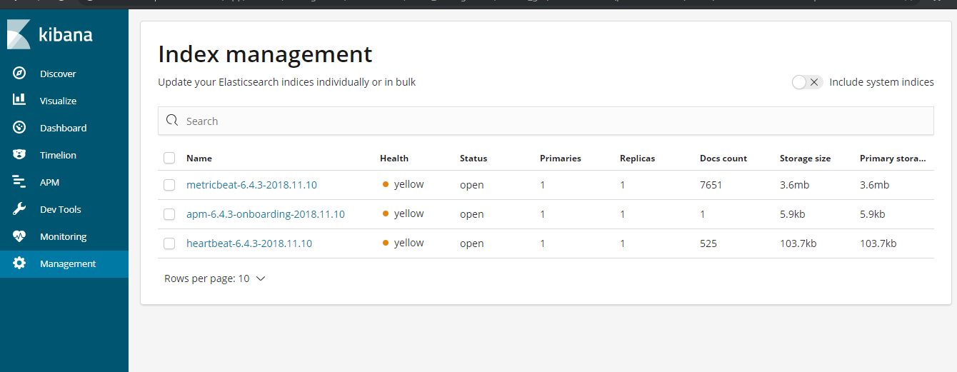

the issue is under the discover TAB i am getting logs against merticbeat-* and heartbeat-* indexs but there no logs against the filebeat- index*
please find the screen for the references
