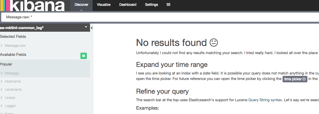

I'm using Kibana 4 with ElasticSearch 2.3.5 to store and search logs. I have a "Message" field which is analyzed and a "Message.raw" field which is not analyzed, this is configured in the mapping template.
From the Settings tab in Kibana I can see the Message.raw field is exist.
But when I search for "Message.raw" field I can't get any result.

Do you know what I'm doing wrong here and how can I fix this?
