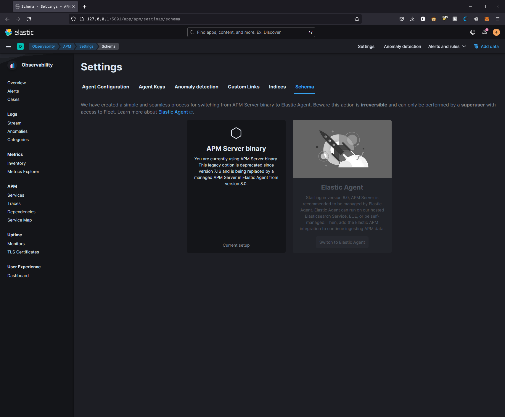

Also, if I go APM->Settings->Schema, it "says" that I'm running the old binary, even though elasticAPM integration was installed/added w/fleet.
issue (I'll ask around), but regarding the Node.js Agent

Re: the other issue I mentioned:
Hey,
about the apm-server:
I see that the integration has been installed. How is the apm-server running? Is it running independently in its own docker container? Or, did you add the apm integration to an agent policy, and the elastic-agent assigned to that policy started and is now managing the apm-server?
The latter; it's installed as an integration on elastic agents.
Can confirm this behavior on both 8.2.x and 8.3.0. Is the actual behavior deviating any way from what you would expect, or preventing you from managing APM Server via the agent policy? I'm hoping this is just a visual bug.
EDIT: After some light investigation, it appears to be a visual bug, and should not affect the actual apm integration. If you find that something is in fact wrong with the integration, let us know. Thanks for reporting this!
Re: your last reply, if you are specifically referring to the issue where it says/shows I am running the old bin version, then - yes, I believe it probably is just a visual bug and - no, other than the seemingly incorrect display in that particular view, that issue seems to be isolated to the view and not affecting management or usage of the APM server. If you meant something else than please let me know
