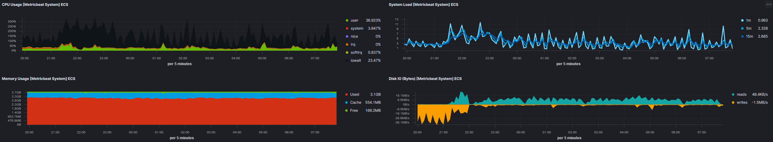

Here the metrics of the last 4 hours during which 3 crashes occurred:
So, would it be correct to assume that the node is crashing due to something elastic related? If so, what could I check to find the root cause?
To reiterate, it's taking over a minute to write a small number of tiny files to disk. That doesn't sound Elastic-related to me, it sounds like a failing disk.
